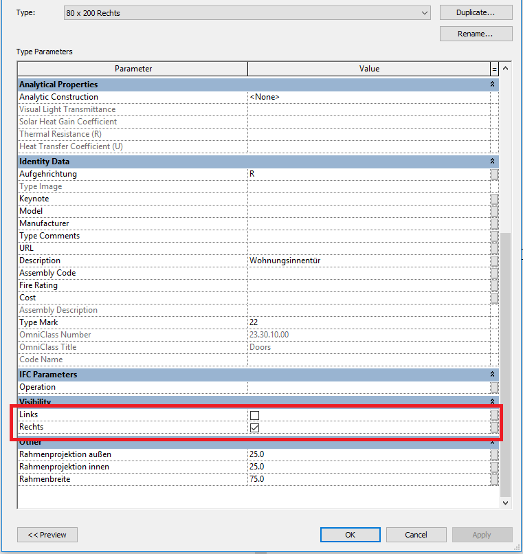

How about creating that shared parameter and then:
filter the category’s elements according to whether they have the left/right parameter - the ones that don’t have that parameter “filled” (something like a tick box in the second image) would be excluded out of the selection (20 or 10% in your case);
apply your tag graph to the selected 80% - 90% doors
You can maintain the shared parameter even if it’s not used/checked in all of the family types. Does this make sense?
