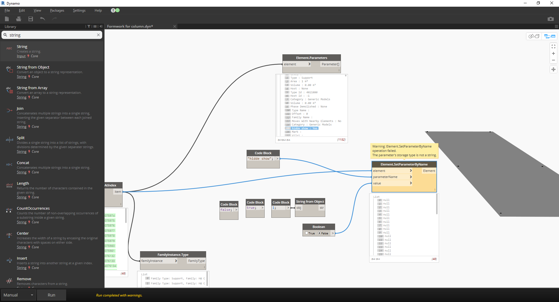

I’m trying to change parameter in nest family but it failed only report Warning: “Element.SetParameterByName operation failed.
The parameter is read-only.”

You are giving the parameter a true/false value but I don’t think it can read it like that way.
Maybe you should give it a string like “true” or “false”.
True false values are usually 0 or 1.

I tried it out and it seems to work. Both with the Visibility-Parameter being linked to the “hidde show” Parameter as well as it not being linked to it. Try my graph out. Hope it helps.

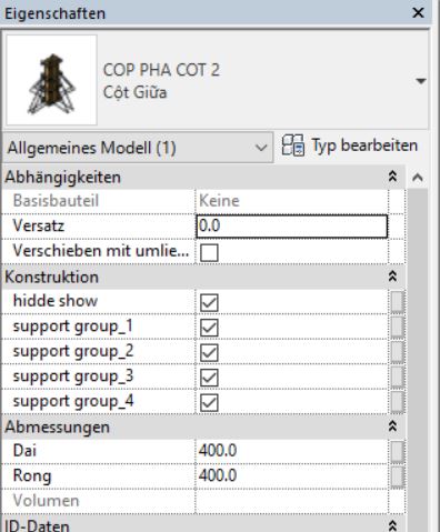

Your Global Parameter Typ was set to “Text” and two different Parameter Typs don’t go together (Text and Yes/No) so I deleted it and created a new Global Parameter with the Typ set to “Yes/No”
Then selected the Family and linked it’s “hidde show” Parameter to the Global Parameter “hidde show” and it worked.
Sometimes I have to select the Family again because I didn’t get the one having the “Supports”
So I think it’s better if you go into the Family and change the “hidde show” Parameter to a “Typ” Parameter, then Link it from the Typ editor to the Global Parameter.

Ja, that’s true. Thought your goal was to show or hide all. But if you want to show some and hide some then you need to set each Support to a different Visibility Parameter.
I paired them here, naming them “support group_1” and so on
Then created a Global Parameter for each, naming them thesame and used the same Graph as before
You can control their visibilities in the Glabal Parameter section or if you want to use Dynamo then maybe the Dynamo Player is better.
I changed the Parameter names to match each Global Parameter created
Hope it brings you closer to what you are trying to achieve.
