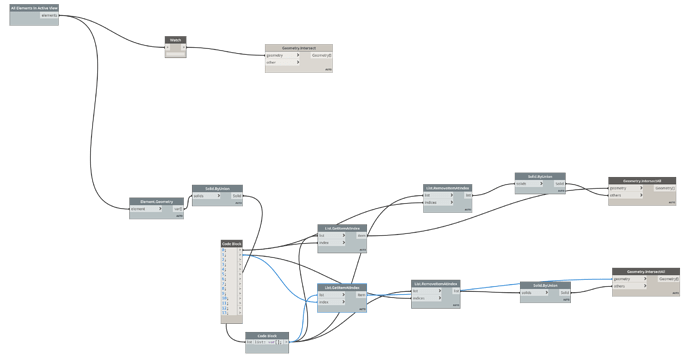

here is simplified version

hmm… 111 if i want to detect intersection,
i want like this one
You want the geometry that is the overlaping every element with the total geometry of every other element? If so, from Element.Geometry ensure you have only a single solid per element, then:
List.RemoveItemAtIndex with a range from 0 to the length of the list minus 1. You should get a list of lists of all the geometries with one item removed from each sublist.
Union each of the sublists into a single solid. This will help reduce computations in an up coming step. Flatten this list node if it’s not only two levels deep.
Place a Geometry.Intersect node, where the first input is the contents of the original element.geometry node and the second input is the solid.byunion node.
Lacing and list levels will matter throughout, but I have seen this method work.
That said, be sure to limit your lists - if you attempt this for a list of elements that is let’s say n items deep you’ll be performing n^(n-1) solid unions, and then n geometry intersections. I may be off in my count, but I think you have 23298085122481 geometries you’ll be doing boolean operations on at one point. Likely there is a better way to solve whatever your problem is (such as the Bimorph node above).
That means my method is too big to be useful?
Not necessarily, it just means you might be approaching your problem in the wrong way to begin with. What are you really after?
I want to see the overlay clear and intuitive in every model. Through this, we also want to model more accurately and further calculate the exact quantity.
