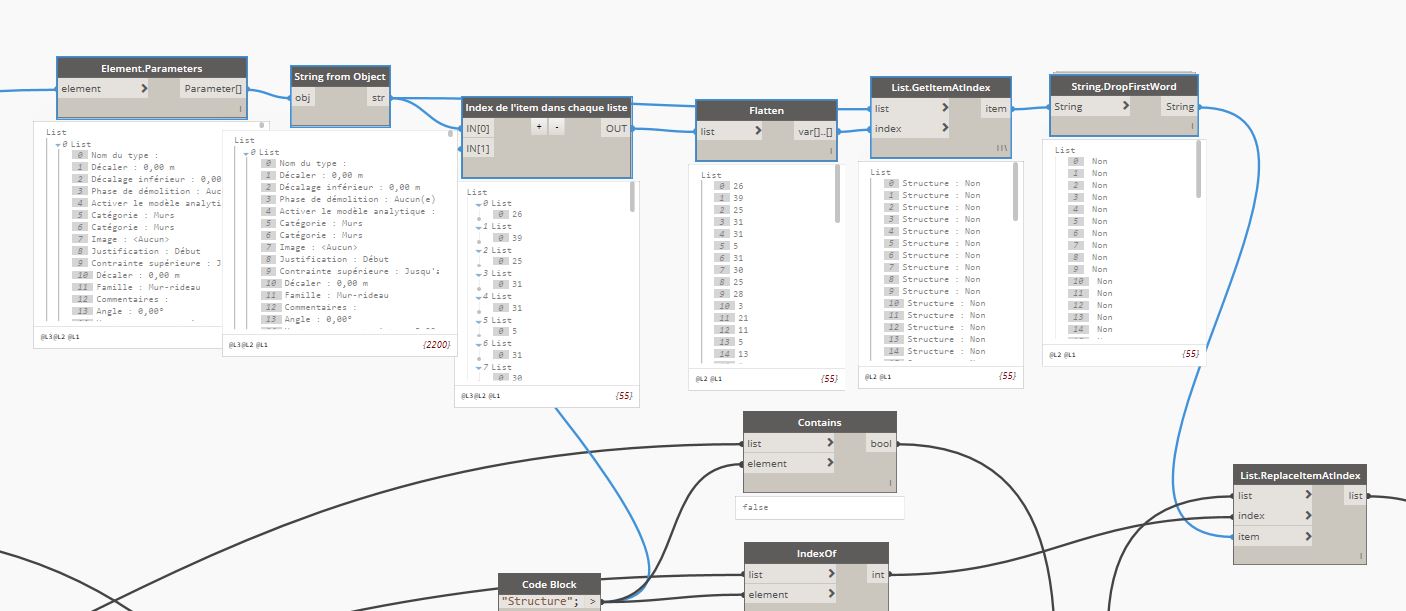

The information extracted by my script is for “Fonction”: “1” and it should be “Exterieur”. How can I fix that
we need a bigger picture to understand what is going on there

The problem is more complex as I have a lot of automated tasks and the parameters checked are read from an Excel List

I have several parameters to check for more than 55 curtain walls and the position of “Fonction” is not allows the same.
I have 5 other parameters with the same issue (structure…) and the parameters I have to check are read from an Excel List. I don’t know how can I use your script for this situation, and it could be really heavy is I have to use a dictionary for each case.
