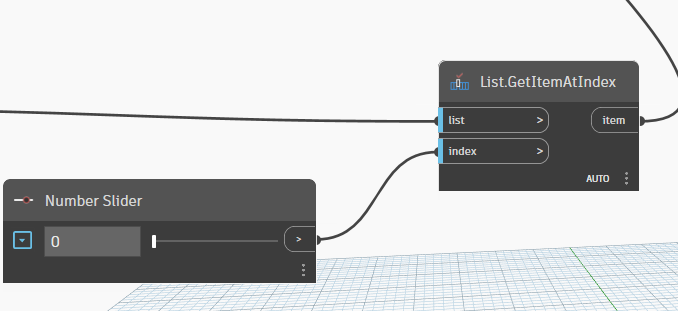

I’m importing revit page numbers from an excel file. Then I translate these into page names. Afterwards, I automatically go to the views they are in and do the PDF and DWG conversion. However, it only does this for the cell in the 1st row of Excel. I can choose which row to convert by adding a parameter, but how can I do it all at once?
Or, can I loop it with parameters?
Can you show thr data with a watch node after the last string replace
If you remove the List.GetItemAtIndex node and reconnecting it should process the full list

If you want to loop in Dynamo then use the ‘count’ node.
So if you have 10 items use the count node to tell you it’s 10 in that list. then type
0… n-1 in a codeblock. Plug the count node into the codeblock, that’s your n value.
That’ll create a range. You start at zero because dynamo is zero indexed and n-1 will give you 9 in this instance which is the last item in your list.
Use this range to tell Dynamo which excel rows you want to read.

The problem is not there, it does not match the resulting values ​​when we send them as an array. However, it works when I send it individually.
I have no idea what your data looks like - maybe show some of the outputs of the nodes.
But I’m going to suggest that you try changing the lacing of the String.Replace nodes…
Also, if you can write Python it would be easier doing the lot of that in Python.
When you enter 1 or a different number in the index value, it works. However, when I send it as a list, it doesn’t work.
Eureka
You need to look into list levels. That is how you control “looping” in Dynamo nodes. Dynamo automatically iterates over an input structure (i.e. loops) but you sometimes have to specify how that list structure should be handled. That’s where list levels come in.
