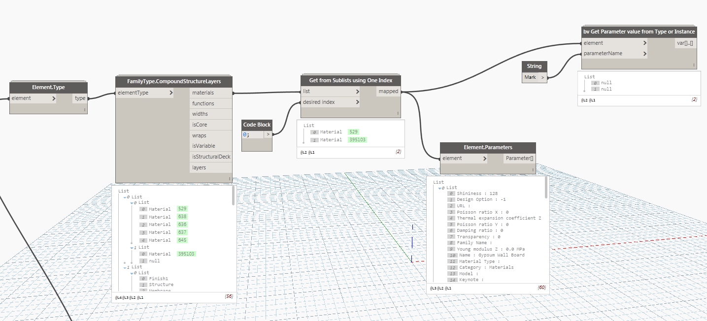

Works for me with the built-in GetParameterByValue node. Have you tried that one?
I try it before. Actually, we can get parameter of the element, but the parameter of material cannot be gotten. I also find the many ways, it does not have the result.

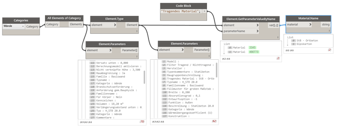

this should work
Johannes
I see, but I want to get the mark or description of these materials.
like this?
that’s right. But the parameter name is mark or description, etc …
