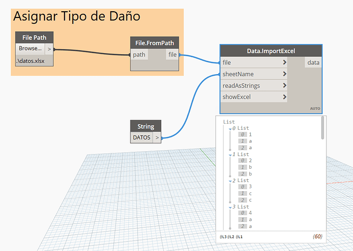

I have uploaded a dynamo, where there is only one operation. Indeed, is the first part of a more complexed file. I do not know why it doesn´t work. Any comment would be helpful.

Works for me:
Do you have excel file open before you run? If yes make sure you close excel file before you run.

It still doesn´t work, with excel opened and excel closed.
I have noticed that i have two notifications. I don´t know this is related with the problem.

Try removing all Revit add-ins, restart your system, and see if that resolves the issue with the excel node.
What version of Office/Excel do you have?
I have istalled the new version of dynamo 2.03, but still does not work.
I have tried in another computer and it works.
I do not know the reason
What version of office?
This script also works for me Natalia, maybe one of your Dynamo Packages and/or Revit Add-Ins bugs Dynamo.
Office 365 2016.
I think it is related with the installation of the Office (Excel).
32 or 64 bit?
