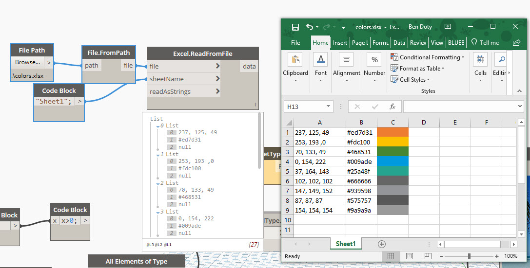

I have had better luck using the OOTB Excel file reader, Excel.ReadFromFile
How did you get that node? That is the exact node that the tutorial recommended, but I couldn’t find it.
i think Benjamin_Doty1 is using Dynamo Version 1.3 /2 and you are using 2.0
