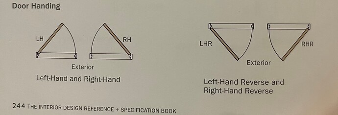

It would seem like we need a way to categorize/sort the “Type” of room in order to ensure that “exterior/interior” always corresponds to “less secure/more secure” which seems to be the working definition my team uses. I’m not totally sure how to reconcile exterior/interior otherwise for the purposes of determining if a door is reversed.
Basically it seems like the script works, except in reverse, if I have no room on the exterior side. If I have a room on the exterior side, no side is considered to be exterior by the script and it default to LH/RH only (no LHR/RHR). Is that accurate?
This would be wonderful… but it would require that everyone work to the standard you referenced (or any one standard for that matter). Since the global industry doesn’t have one standard (or even a 2/3 majority) Revit can’t enforce a standard and therefore Dynamo can’t produce a standard. This is doubly complicated by the previous post around ‘the source families aren’t usually reliable’, as if the door swing is opposite what the standard expect we get opposite results.
