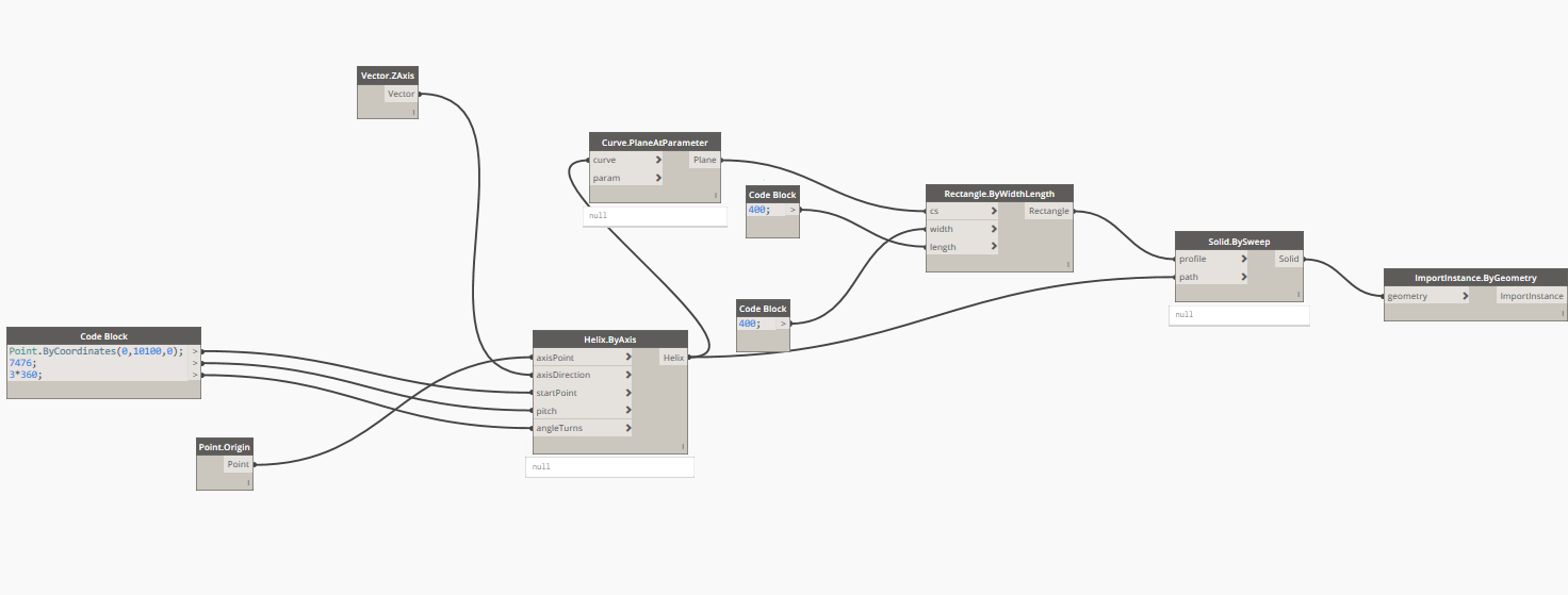

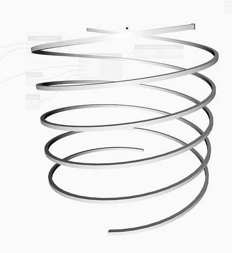

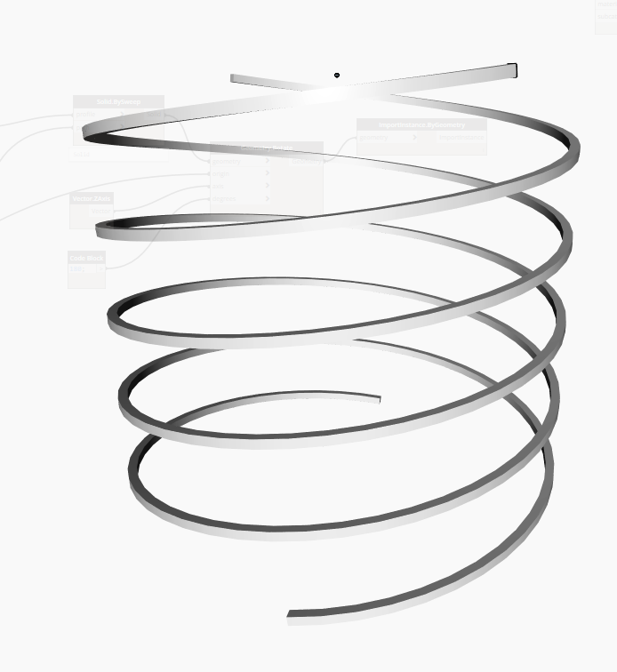

Hey guys. i wrote a little script, to make a Helix. As for now i made it so that i just extrude a rectangel. The question is if anybody has any toughts on how i can extrude it as defined profile? i have tried with the ‘profile from revit’ node… Not succesfull tough :slight_smile:
The code looks like this
Any help is apreciated :slight_smile: Thx in advantage.
Whoops… like this the code looks :slight_smile:

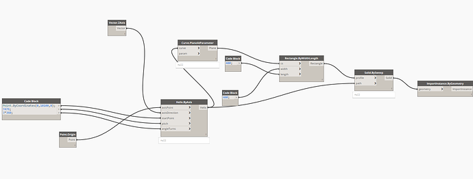

Might actually upload graph too, to save some time on a rebuild for potential answerers.

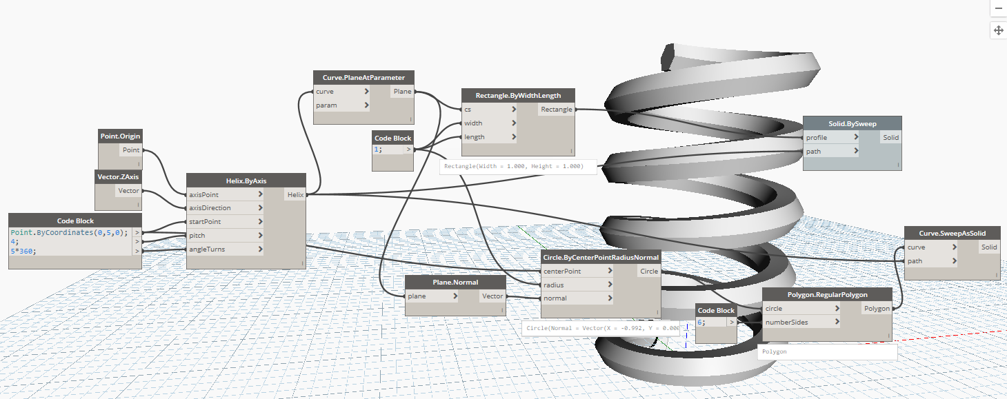

It should work with any profile so long as it’s normal to the curve’s plane.
