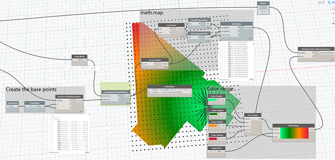

Morning all,
any reasons why my heat map is linear and not circular?
i would play with list lacing (?)
No avail, and i even introduced another set of points… same results
@Daniel_Hurtubise can you post a sample file for people to examine? This is a pretty specific list management issue, and it’s impossible to re-create from the image.
Of course, here’s the link to the dyn and the rvt

GeometryColor.BySurfaceColors need a 2D Array of Colors (and same length)
an example with one wifi extender
Note for multiple wifi extender I think the best is to return the shortest value (distance) for each point (then add wall penalties)
I forgot to come back and update it, it’s fixed by fixing the list :slight_smile:
