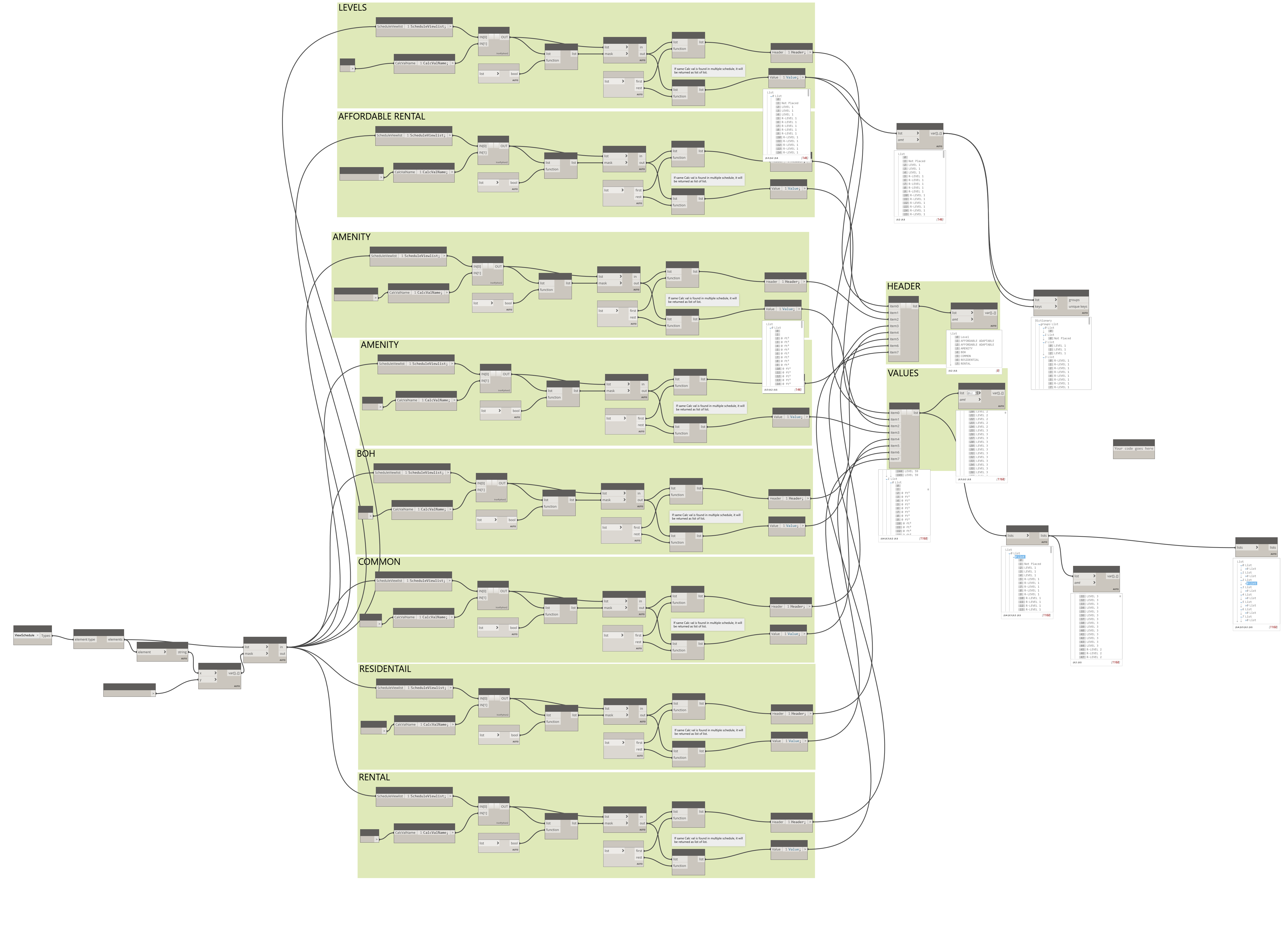

I want to group the Calculated value list according to level and have sum of that parameter.I was able to get the calculated value from the list but could not able to group it and sum it up
so i have one list [a,a,b,b,c,c,d] and another [0,0,2,3,12,3,4] i want the result to be [[a,0,0],[b,2,3],[c,12,3],[d,4]]
what i really wants
and my dynamo script is
