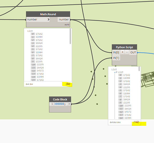

Hi, Not sure what I’m doing wrong with this?
you will need to add another nested for loop if you wanna do multiple list item. From your @L2@L1, i think there is multiple list right?

hmmm seems to be out putting more values then go in?
hi there, changed the code a little because of duplicates. it should suit your needs now
