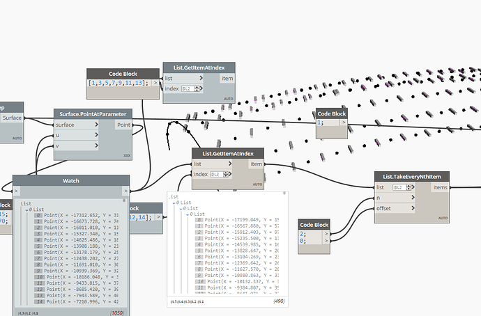

You need to get all of the index numbers first. Then you can filter out the odd ones and use them with GetItemAtIndex. A shortcut would actually be to get the list count (c) for each sublist and then create a sequence from 1 to c by 2, effectively getting you all the odd indices in that sublist.

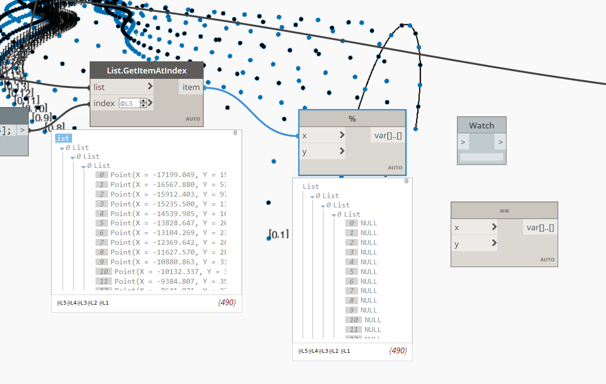

I did what you said and I can’t get the results,
b
are these lists right for what i need to get?

Your list level isn’t right. You’re getting the count of each object. You need to get the count of each list. Try list level @L2.
Your sequence isn’t quite right either as that node uses an amount instead of an end. Use a codeblock with 1..c..2.

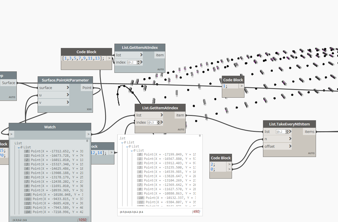

Are you attempting to extract every alternate item?
If you are, you could do that like this
take
If you need items at even indices, change offset to 1

I got the results what I want

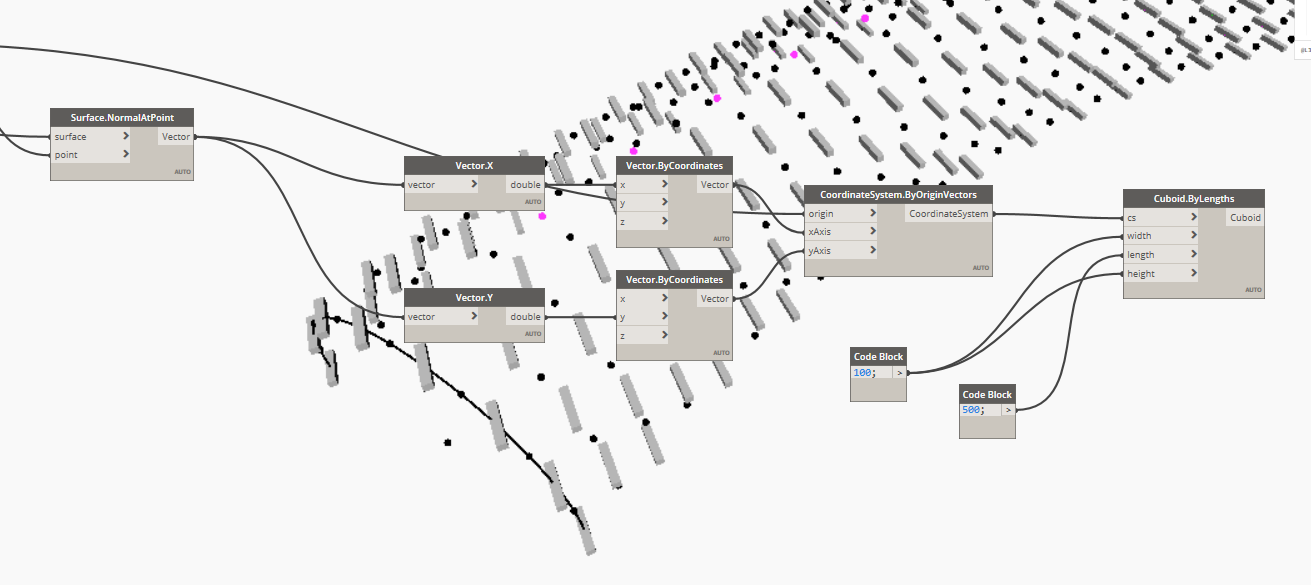

Here, i want the cubids to be parallel with surface orientation
But it works like this
