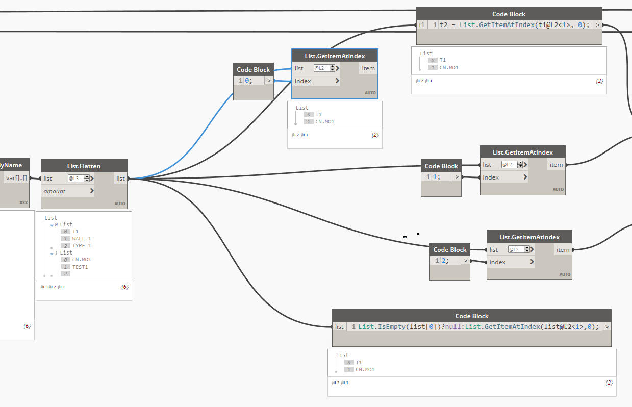

I would like to remove the warnings I get on the GetItemAtIndex node for empty lists.
With elements:
Without elements = warnings:
I have tried replacing with design script, but this still gives a warning and I have tried a simple python node, but this also gives a warning. I noticed packaging it into a custom node seems to ignore the warning, but I am not getting the same values out now from the custom node.

Here is inside the custom node if it helps…

The DS conditional statement worked well. I did Node to Code on the List.GetItemAtIndex to get the syntax for the levels to add to your conditional statement.
When empty list fed through:
With data:

Thank you for the link. I think I need to spend more time with DS syntax to get my head around it. Your code is working except I cannot get the list levels correct.
The highlighted list is correct. I am sure it is really simple!
