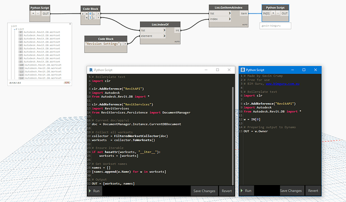

Seems to work if you just don’t use the archilab worksets - for some reason they have less properties available to inspect such as Owner.
worksetowner.dyn (10.8 KB)
The Owner property won’t return Borrower though, as the OP is after :wink:
Don’t know if borrower is exposed. I couldn’t find anything atleast when I went through the various Workset related classes last night.
Yes you’re right. I tried finding a reference to borrower and no luck either. Onto the wish list forums it goes I guess…

Ah I misinterpreted the intent so got the owner property of the workset vs borrower. This is usually a property of any workset kind, but it looks like archilab converts their workset objects to a custom archilab class instead.
Here a workaround
there may be some optimization to be done by adding a filter in the collector
import sys
import System
import Autodesk.DesignScript.Geometry as DS
#import Revit API
clr.AddReference('RevitAPI')
import Autodesk
#import net library
from System.Collections.Generic import List, Dictionary
#import transactionManager and DocumentManager (RevitServices is specific to Dynamo)
import RevitServices
uidoc = uiapp.ActiveUIDocument
app = uiapp.Application
currentUser = app.Username
elems = DB.FilteredElementCollector(doc).WhereElementIsNotElementType()
out = {}
for e in elems:
	wksetstr = e.get_Parameter(BuiltInParameter.ELEM_PARTITION_PARAM).AsValueString()
	# get worksharing info
	wsu = WorksharingUtils.GetWorksharingTooltipInfo(doc,e.Id)
	# get current owner if different
	if wsu.Owner != "" and wsu.Owner != currentUser:
		out[wksetstr] = wsu.Owner
dictBorrower = Dictionary[str, str](out)
OUT = dictBorrower
