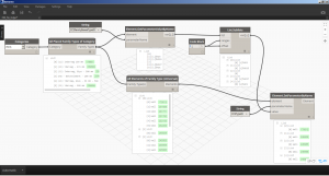

I’m not sure if i’m approaching this the right way, but i managed to get this far:
So now i’m stuck with a list of types, and a list of instances…-how to give the list of types the correct indices and lengths, so that the type parameter will end the right place?

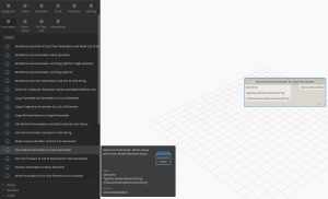

I have a node for this in Bakery, if you want to adapt to your own use go ahead:

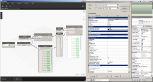

wow, Mr, Johnson, that’s…nifty! Thanks a lot, I’ll be using that a lot in my new job. We have to use a type/object classification system, and it still has some bugs, such as having a type parameter as an instance parameter.
I oversold my skills at the job interview, so now i have to impress
Thanks agin for the help.
