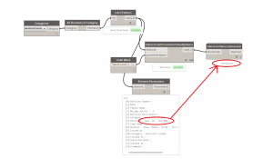

This is probably really easy, but I’m stuck. I’m trying to retrieve the information about the revision clouds from Revit. Can I get a little help. When I try to retrieve the Revision information from the Revision cloud, I get the element ID, but I want the text. Any thoughts?
Which Dynamo version are you using? This is what I get using Dynamo 0.8 on top of revit 2016 (also, why is your GetParameterValueByName node’s lacing set to cross product?):
