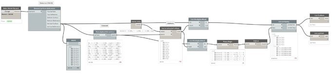

Hi guys,
I have a list surface from element.
I get all surfaces is parallel.
After that, i want to get two surfaces outermost.
What can i do to get them?
I thinked to use Local Coordinate System, but then i don’t script to continue.
Many thanks.

Hi @mr.engineer.aec,
According to the picture you shared.
You could use the properties of the plane and in particular sort them by their origin.
Hi @Alban_de_Chasteigner
Thank for your post.
I solved my issue with your solution.
