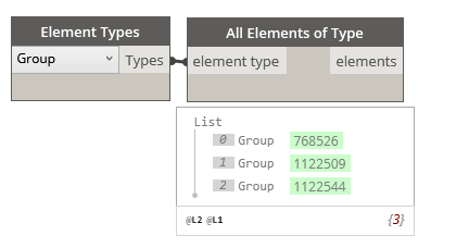

Use Element Types to get only the placed groups (detailgroups included)
“Group” gets all groups and thats not what I want. When I select “GroupType” I get less Groups. This is what I want but I also get the (unplaced) ones. And I would like to eliminate these from my list.

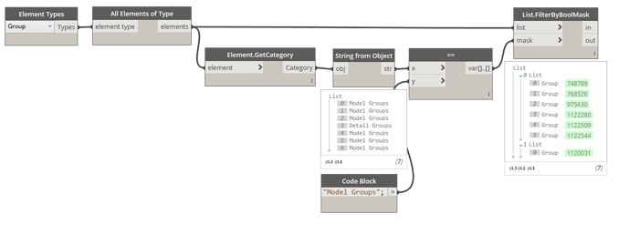

The method I described also returns “detailgroups”, “attached detailgroups”. So you’ll have to remove those afterwards to get a list with just the placed MODEL groups.
I use the Element.GetCategory node to filter them.
