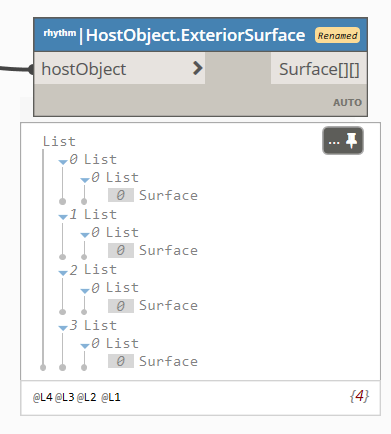

The closest I’ve got so far is by using this node from Rhythm:
But, as you see below unless I mitre the wall join (the left join) I get gaps in the surfaces.
(the mess is all the different ways I’ve tried to do this :smiley: )

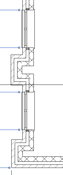

Another example… This in Revit:
ends up in Dynamo like this:

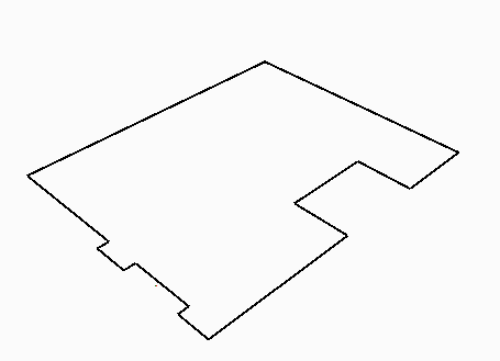

I’m trying to get:
The surfaces/ faces of the perimeter (red line) of the building into Dynamo with no gaps.

OK so I used this thread:
To get the perimeter:
