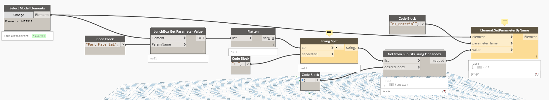

I’m having an issue with getting parameter values when selecting elements in a revit project. What I’m basically doing is taking fabrication part data from fabricationCAD and writing it to a custom data filed in the form of shared parameters.
The end goal here is to allow users to select elements and copy fabrication data to revit parameters for use in schedules, filters, etc. I have a working script that does the entire project at once, but that can be time consuming and being able to update parameters based on selection would be nice.
This is what I have right now:
It works when selecting multiple elements, the problem arises when I select only one. When trying to run the script with only one element selected the get parameter value node from lunchbox seems to break. I think it is trying to iterate an array of one item and returning 0 as a result, but I don’t know enough about DesignScript to fix it or even know if that is really the problem. So I’m looking for alternate solutions.
Can you try this as well and show us what it says? Want to make sure we are looking at the same information. Also can you check that (in Revit) in your Material menu that is shows the names correctly.
The parameter is coming from the fabrication database used with the fabrication parts tool in revit. It has no autodesk material assigned to it. It is purely a data field coming from FabricationCAD, one of many fields I’m writing scripts for. As revit stands now we only have access to a few of the data fields in revit (circled in blue), but there are many behind the scenes that can be accessed with dynamo. That’s what I’m shooting for here, just brining those hidden data fields into revit so they can be used. Its working great, unless I’m trying to run the scripts on one element.
I gave up on this part and moved on to make a selection filter so that when selecting elements it only included Fabrication Parts. For some reason after attaching that filter to the rest of the graph it started running fine when one element was selected.
