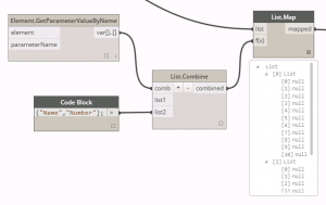

I often find myself duplicating Element.GetParameterValueByName nodes for every separate parameter that I want to pull from a Revit element (image 1). Is there a way to query a list of multiple parameters from every element in a list? I was able to get the desired list structure the List.Combine node but all the values are null (image 2).

Try setting the Lacing of the GetParameterValue node to “Cross Product” (See image). You can then follow with a List.Transpose to split into separate lists grouped by parameters.

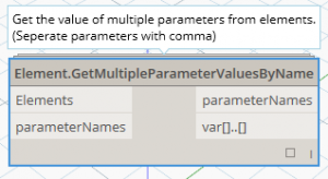

Another way is get multiple parameter values by name from rhythm

Awesome Ben, that was the missing link… Lacing! Thank you for your help.
