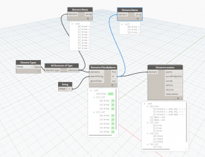

Is it possible at all in Dynamo to get a model groups origin? Or the location of where that particular model group is placed?
Thanks,
Thanks,
Have you tried clockwork’s Element.Location" node?
and just to illustrate what Dimitar had in mind:

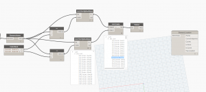

Sweet! It worked, now I filtered what I needed down and I seem to have forgotten how to get the element ID of a string. I know I cant plug in from Flatten to element.
Thanks,
Hi Patrick,
You can use “ElementsFilterByName” node from Clockwork Package to filter your groups by name. Good Luck!
I got it, I forgot that you need to tie in the “All elements of Type” into the “List.FilterByBoolMask” in order to get the actual element itself. Thank you though!
