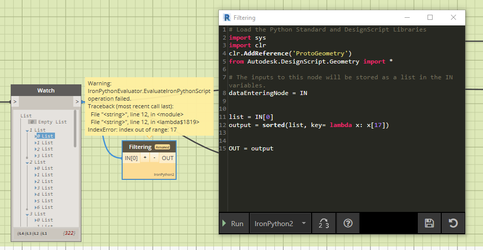

I am trying to do a bit in sorting lists based on given conditions, before moving to the next step.
Here is the problem, I have a nested list with four levels. And I am trying to filter the list @L2 based on sub-list values @L1 - index [17]. I tried using basic sorting, and the attached python code, but unfortunately this is not helping me.
Any suggestions on this, please?
Thanks.
Two options (I think)…
Flatten the list before feeding it in…
OR
Nest the list in python… so for eg.
for thing in things:
    for ing in thing:
        do thing here (that will look at the next level of your list.)
Don’t forget to deal with those Empty Lists. You can pull a value that doesn’t exist.
