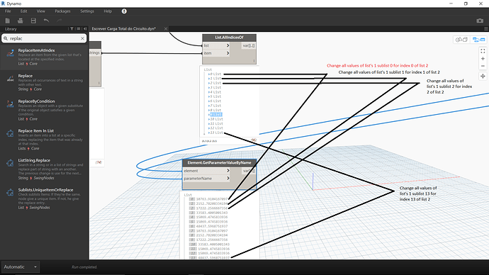

I applied List.AllIndicesof to the list and i got a different list…
Sublists of list 1 are of composed of different amounts of elements.

One approach to achieve this would be to create a dictionary where List 2 are the keys, List 3 are the values, and List 1 are the accessors. SpringNodes package includes a useful node Springs.Dictionary.ByKeysValues to create and access a dictionary all in one:
