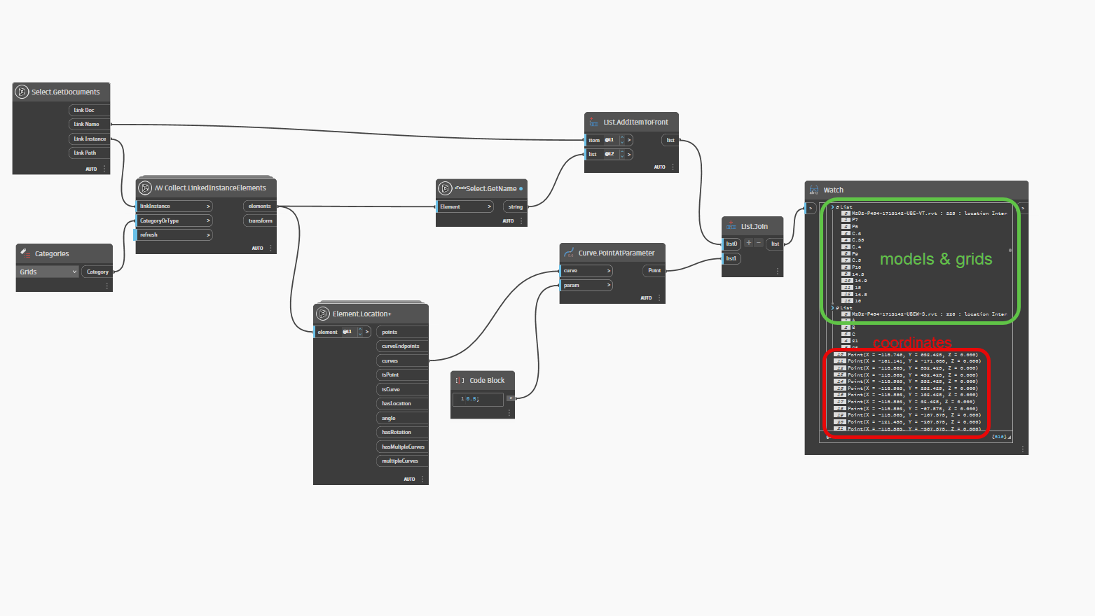

Here’s where I’m at now. Was able to get the grid names listed under their respective linked models. Now I can’t get the coordinates (x,y,z) to show up. Getting closer though!
Good job! :muscle:
looks like you are almost there @michael79
It’s easy to randomly change list levels in various nodes until it looks right- but it is better to logically work out what you want the final data to look like, then think back through each step needed to achieve this.

@bvs1982 This script is almost there! There are, however, a few important things that need to be modified:
The X & Y points are getting calculated by the individual linked model Project Base Points instead of the host model base point (or internal origin. Just need a static place to measure all linked files from). The individual Project Base Points are all in different locations, causing grid lines that are aligned to show different X or Y values, depending on their orientation. This is causing a discrepancy between grid line measurements in the Excel file.
So if Linked Model 1, GL1 is measuring 10’ from it’s own Project Base Point and Linked Model 2, GL1 is aligned with Linked Model 1, but measuring 12’ from it’s Project Base Point, then the value returned has a discrepancy of 2’ even though they are actually aligned.

Also, I realized it’s actually the Internal Origin that differs between models, and that is where the X, Y measurement discrepancy is coming into play, not the Project Base Point. Hope that clarifies things a little more.

@jwroelofs Thanks for chiming in. I mispoke…the Project Base Points and Survey Points are all in the same location (thank goodness!) The Internal Origin of the different linked models is what is different. Dynamo appears to take measurements from the Internal Origin of each linked file, rather than the Internal Origin of the host file. That is what’s causing the discrepancy.
I tried using the Convert Origin node from Genius Loci, but I still get the same measurements for some reason.
Hopefully someone smarter than me can help out lol!
You need to transform the grids from the internal coordinate system to the common coordinate system (survey point or project base point). Get the desired coordinate system, and use a Geometry.Transform to put everything into the same location and orientation which will allow coordination review.

Coordinate systems aren’t really my strong suit :see_no_evil_monkey: , but i think this is what @jacob.small meant(?).
EDIT
I am not getting the expected results when trying this :backhand_index_pointing_up:.
So i must be doing again. But again, not my strong suit :sweat_smile:.
I moved everything 5000mm in both directions in one of our Linked Models.
The top model is from a 3rd party.
@jacob.small Can you tell me what i am doing wrong maybe?
