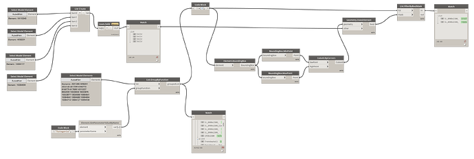

i want to collect doors which are at rooms…
RoomGetDoors.dyn (35.0 KB)
final aim is to count doors per room, how

You can use this node

no, i use this clockwork node… i tested it. i have problems with toilets, because the node counts also doors inside the rooms… … so i can solve it partly. mostly it works well.
later i will use it for windows, but the condition is windows with option to open. I think i have to modify the script.

Once you have the doors, check the ToRoom and FromRoom parameters and if they match remove them from the list.
