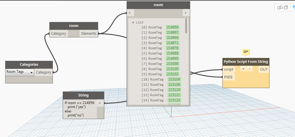

Here In this code it returns a error saying room is not defined as List (I thought it assign the name to the list as i change on node title bar ) ,can you help me how to get the actual LIST name
First of all, that’s not a valid script. You haven’t defined the input anywhere. You should have something like rooms = IN[0] at the start. And because you’re working on a list, you need to iterate through the list. So your next line should read something like for room in rooms: .
Last but not least, you should figure out how to properly output your data, because the only variable that you can output from a python script in Dynamo, is the one called “OUT”. Have a look at one of the many examples of scripts on the forum or alternatively, check out this wiki page for a more detailed breakdown: https://github.com/DynamoDS/Dynamo/wiki/Python-0.6.3-to-0.7.x-Migration
