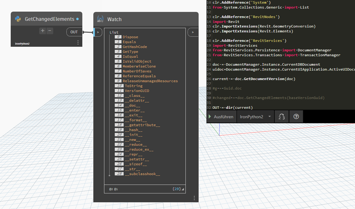

Get a list of changed Elements ? how
i test in revit 2023 with ironpyhton2 getting changed Elements…
… so how is here the correct syntex ?
clr.AddReference('RevitAPI')
from Autodesk.Revit.DB.Structure import *
clr.AddReference('System')
import Revit
import RevitServices
uidoc=DocumentManager.Instance.CurrentUIApplication.ActiveUIDocument
current = doc.GetDocumentVersion(doc)
changed = doc.GetChangedElements()
OUT = current, changed
Get document version works well, but not the changed Elements.
KR
Andreas
The GetChangedElements requires a document version GUID as an input, which is a property of the document version.
@jacob.small
import Revit
#g = Guid.doc
changed = doc.GetChangedElements(VersionGUID)
OUT = changed
grafik
it seems to be correct, BUT it can`t find it.
KR
Andreas
First up: a quick note: These APIs were added in 2023, and updated in 2024. As a result it won’t work for those of us who haven’t updated yet. So for anyone who wants the new toys, make sure you upgrade first. :slight_smile:
Now then… to get the changes between versions of a thing you need a basis of comparison. This is what the versionGUID input is for. However that version GUID can’t be pulled from the current document version, you need an old one. So functionally you’ll likely want to provide a path to the previous version of the document. With that you can either get the BasicFileInfo and pull the DocumentVersion from there, or open the file in the background and get the info from the background opened document. Usually I don’t recommend keeping documents open in the background, but it could be useful here… More on that in a few.
Once you have the document version, you need to pull the VersionGUID as that’s how Revit keeps track of everything for comparison. From there the doc.GetChangedElements(oldDocumentVersionGUID) method should work. The resulting object is a DocumentDifference object, which has methods to pull the modified, added, and deleted element ids. From there you can get the elements from the model fairly simply using the doc.GetElement(id) method.
However, this won’t work on the deleted elements, as they no longer exist in the active document. Instead you’d have to pull them from the background opened document (which is why I thought keeping it in memory might be a good thing here). With the old document open in memory you can do soemthing like this: deletedElements = [oldDoc.GetElements(id) for id in deletedElementIds] which will give you full access to the elements with anything they may be able to do with them in the Python environment, and in some cases beyond as I am showing here (Revit 2024.1 with Dynamo 2.18):
