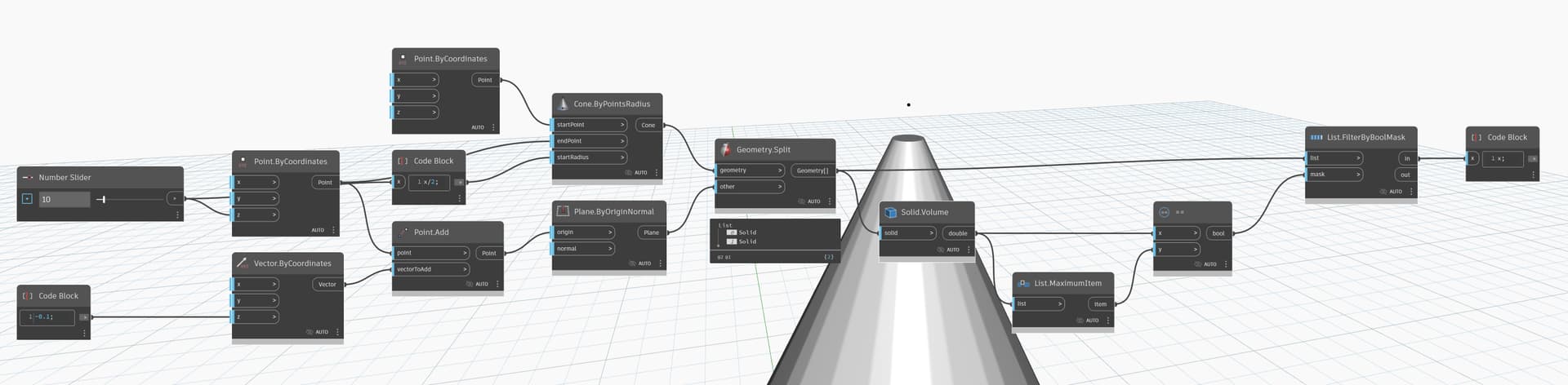

I created a Geometry with Dynamo, a concrete cone, it is a solid, but when i convert to a sat file, in Revit apperas like a mesh, and dont show volume. Could you help me please.
@Ocadiz6 When Revit can’t recreate geometry using it’s own geometry engine, it will fall back to a mesh import which becomes less useful.
My best guess is that given a cone has an infinitesimal point at the top, which Revit cannot create, it is failing and coming in as a mesh. I suggest you every so slightly cut the top of your cone so that Revit can recreate it. Something like the following:
Thank you very much for your response. I will try it.
