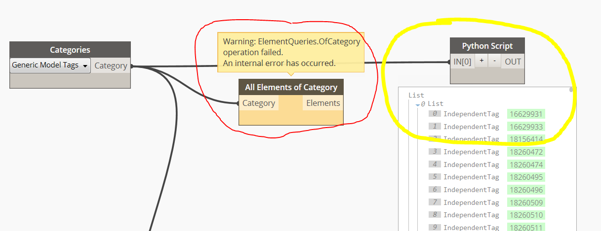

"Generic Model Tags" category - "ElementQueries.OfCategory operation failed" internal error
Took me sometime to get back to this problem. After quick search found out that this bug exists in the Dynamo itself, as per the post here, where it explained clearly:
So to solve my problem I quickly modified the code from @Dimitar_Venkov to collect all the elements of category and not from the specific view. Here the below the code which worked for me:

I am using Revit 2018.3 and Dynamo 1.3.3.4111. Thank you.
