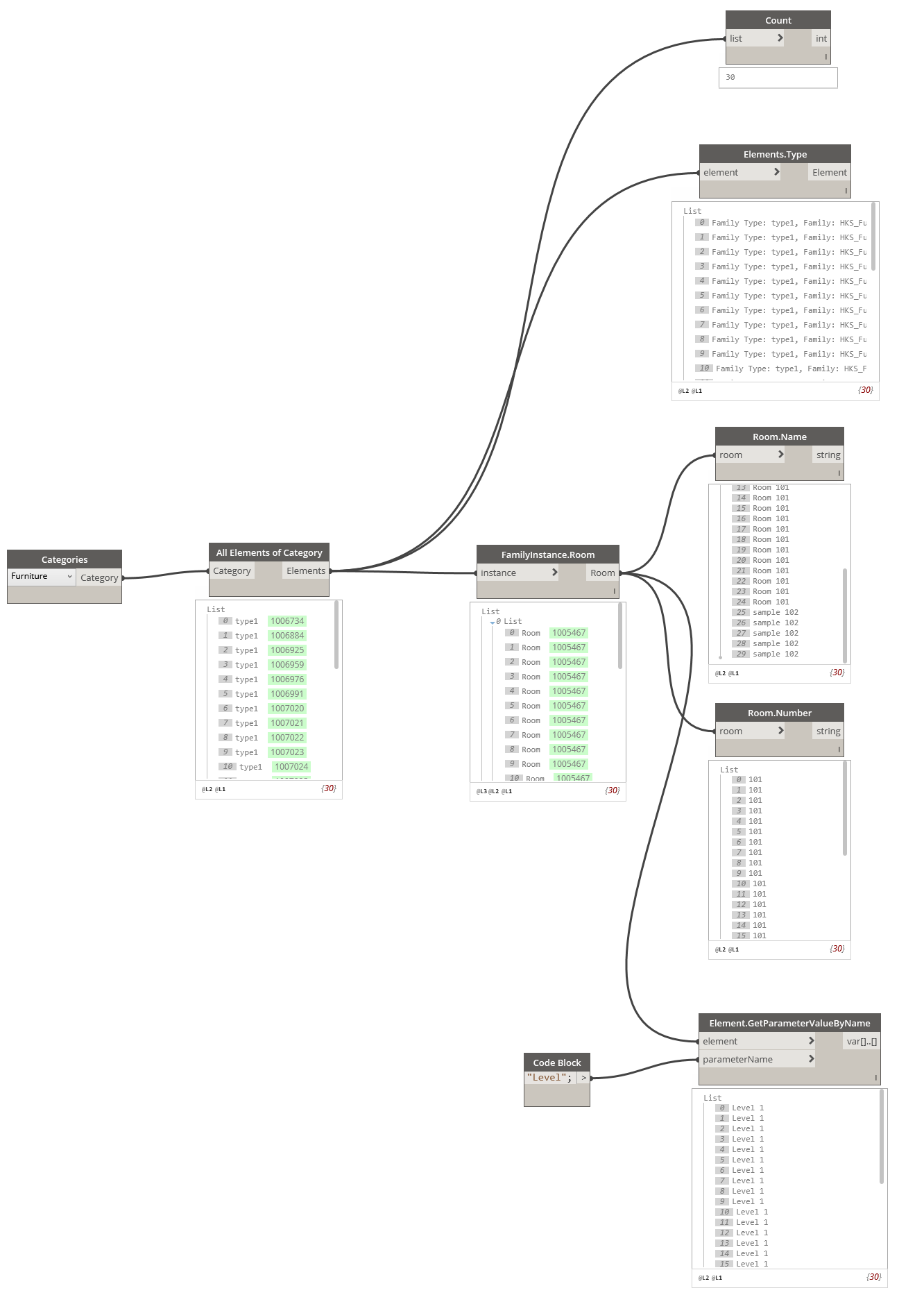

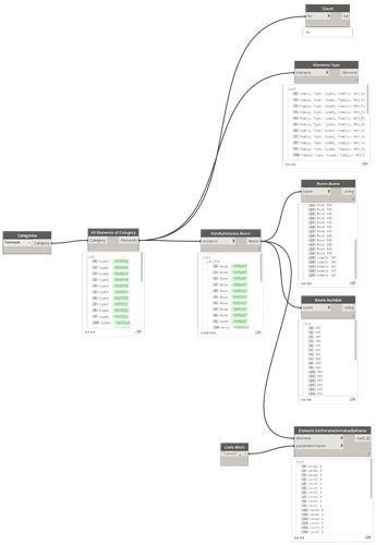

This is very doable.
You have to collect furniture and group them by the key element.room (from package rhythm)
Search for grouping casework by room location to help you out.
Also here is a quick graph @saju_autodesk (Element.Room is from Rhythm)

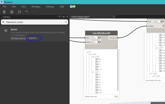

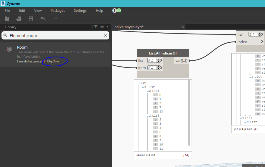

hi under what package can i find the Element.Room?
In package Rhythm as it is written in post 3.
Found it.
Thanks, missed that post.
Is that node renamed to “FamilyInstance.Room”?
or Iam i using some older package.?

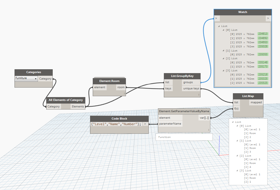

I’m following Jean’s post but don’t know how to map the furniture’s into the room it belongs to. :frowning:
Yes, FamilyInstance.Room seems to be the new name of the node.
@Revit_Noob could you elobrate the issue you are facing.? A snip may help.!
my snip would be the same as with @jean…
i want to be able to count the number of furniture’s in a room…
Level | Number | Name | Furniture Name | Total |
I might not understand the issue but what I would do was:
Organize the furniture “types” and check if they were inside the rooms with:
Some thing like this…???
the node “Element.Room”
