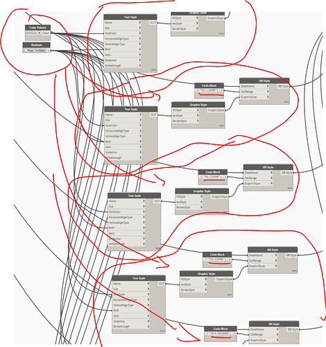

I’m trying to use Bumblebee pack to set excel template for my datas.
I don’t know the formula that I have to put on code block to say to take varius columns.
Simplifying:
Color all cells from A3 to A999 y from D3 to D999 y from R3 to R999
(at this moment I’m just duplicate all nodes for every column, but I’m sure exist a better manner todo so)

I’ve already done a search, but I really don’t know how to put together lists of columns in a single code block line. The Create list node doesn’t work with this group of nodes that I’m using.
Basically I would need to write on the same line: “A1:B1000 + D1:E1000+K1:L1000”

According to your suggestions
I think this node (BB Style) doesn’t works with groups of cellrange
Based on what you’re trying to do, the second image should be correct. Any node will work with lists, that’s a core Dynamo feature. You just have to match them to the node’s functionality and your list structure.
"D4:E1000,K4:L1000" is a single string. Notice how it doesn’t show as a list of two values.
["D4:1000","K4:L1000"] is a list of two strings. Notice how it shows the list levels.
The BB Style node takes a cell range to apply the provided style. That cell range does not have to be continuous. The single string you provided will style all those cells based on single font color you provided. In your case, it sounds like you want different cell ranges with different colors (each of the groupings you have currently). That requires a list of ranges for a list of colors.

I solved using the same node for each column group and works fine. I tried all manner to write the same list, but actually I think the node doesn’t acept separete groups of cells
