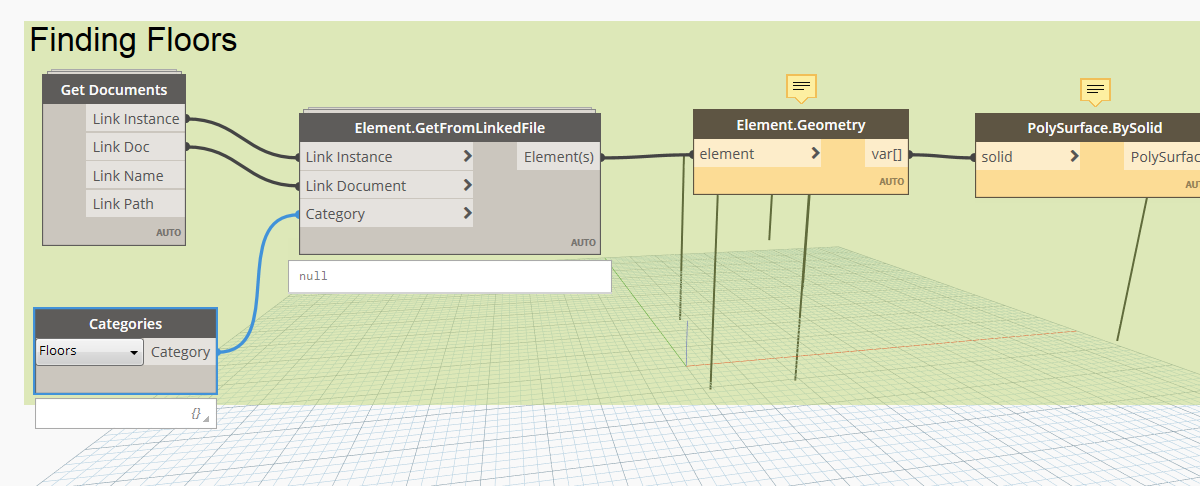

I am trying to find floors from the linked file as shown in the tutorial in this link
but i cant able to get it work. I have a link with floors in the current file and created two type of floors (Architectural and Structural).
your help is appreciated.
PS : I am new to dynamo.
Can you expand the preview under the Get Documents node ?
You have probably several links and you must choose one.
Use GetItemAtIndex to choose the link. (Beeetwen Get Documents and Element.GetFomLinkedfile.
P.S : The package SteamNodes isn’t updated for Dynamo 2.0.
Its weird that it didn’t work before the post. and the same worked after the post.
I did nothing just closed and opened the revit.
