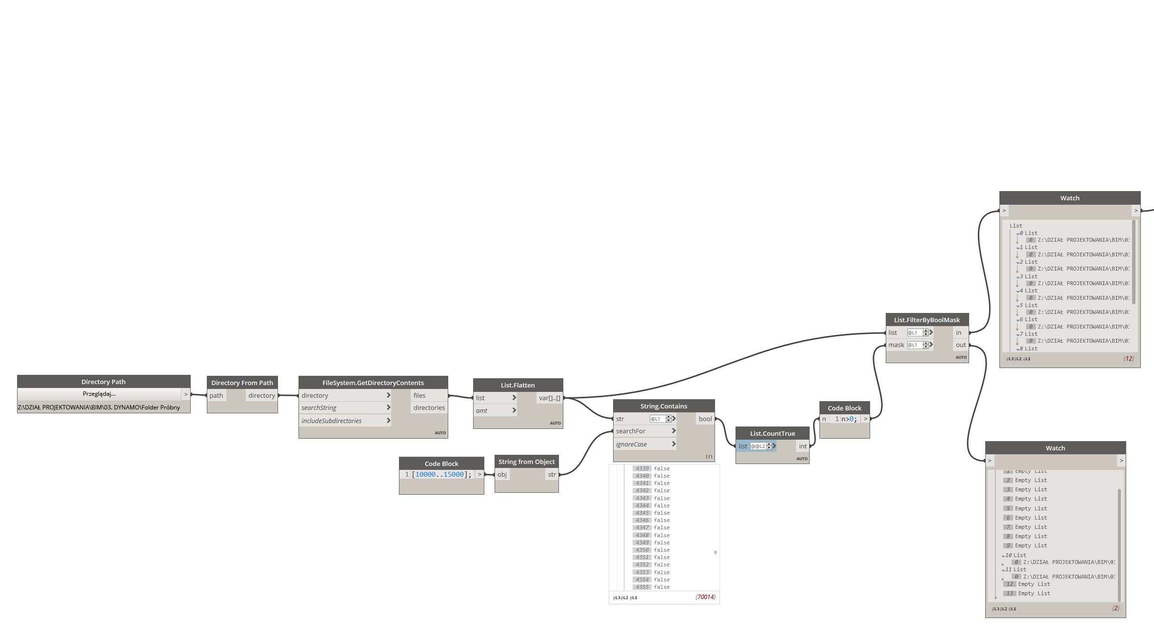

I am trying to filter the files from a directory whose names contain an element from another list and move them to another directory, which is also selected by the same number in the name.
I am only at the beginning and already got stuck…
When I use the list.contains node to search for files with the (xxxxx - number from the second list) it returs value false to all items, eventhough some of them contain it.
I am new to dynamo, so I would appreciate a clear explaination

Ok, so I’ve reduced the data sample, as you’ve suggested and I’ve changed the node list.contains on string.contains.
Now I can find the item with a specific number in the list, but I would like it to find all the files that contain a 5 digit number in brackets (from 10000 to 15000). I’ve tried the list as a “search for” argument but it doesn’t work.
I hope now it’s more clear what I am after.
Please focus on the filtering filles by the GOLD no group.
