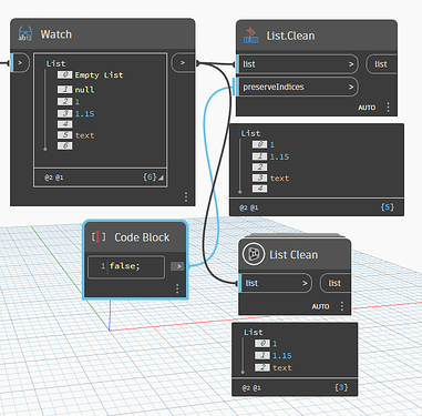

Looks like the circled items are empty strings, not null values.
My recollection is that originally without the ability to use ListLevels it was difficult to manage removing content without removing list structure. That was… 7 years ago now? (side note: I am old now). There were also some which allowed replacing empty strings and null data with an alternative data type, which in my opinion is t cleaning the list but replacing data.
There’s a lot of misunderstanding around what the List.Clean node does and how it works (i.e. preserveIndices). Most people try to use List.Clean to remove bad data or structure that they don’t understand. They end up using a custom node that does what they want without understanding what they’re actually doing.
In this case, there’s nothing in the original list to clean. There are no null values and there are no empty lists out of alignment. List.Clean doesn’t just remove empty strings or sublists containing unwanted values.

OOTB
GeniusLoci
Different nodes for different tasks with these two nodes. I am not sure when I would want to remove empty strings from a list of data though - perhaps the original poster has a use case though.

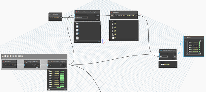

hm I am not sure if I am doing something wrong, but I keep getting the same
I had to use L3 because at L1 and L2 it hasn’t done anything
And I get the same if I use the first solution you mentioned
did you mean something like this? Because I would still get the same result
@BIM00
oh, right, thank you! But I still get the wrong result
In the List.FilterByBoolMask out list is empty and in list has the same amount of title blocks as at the beginning

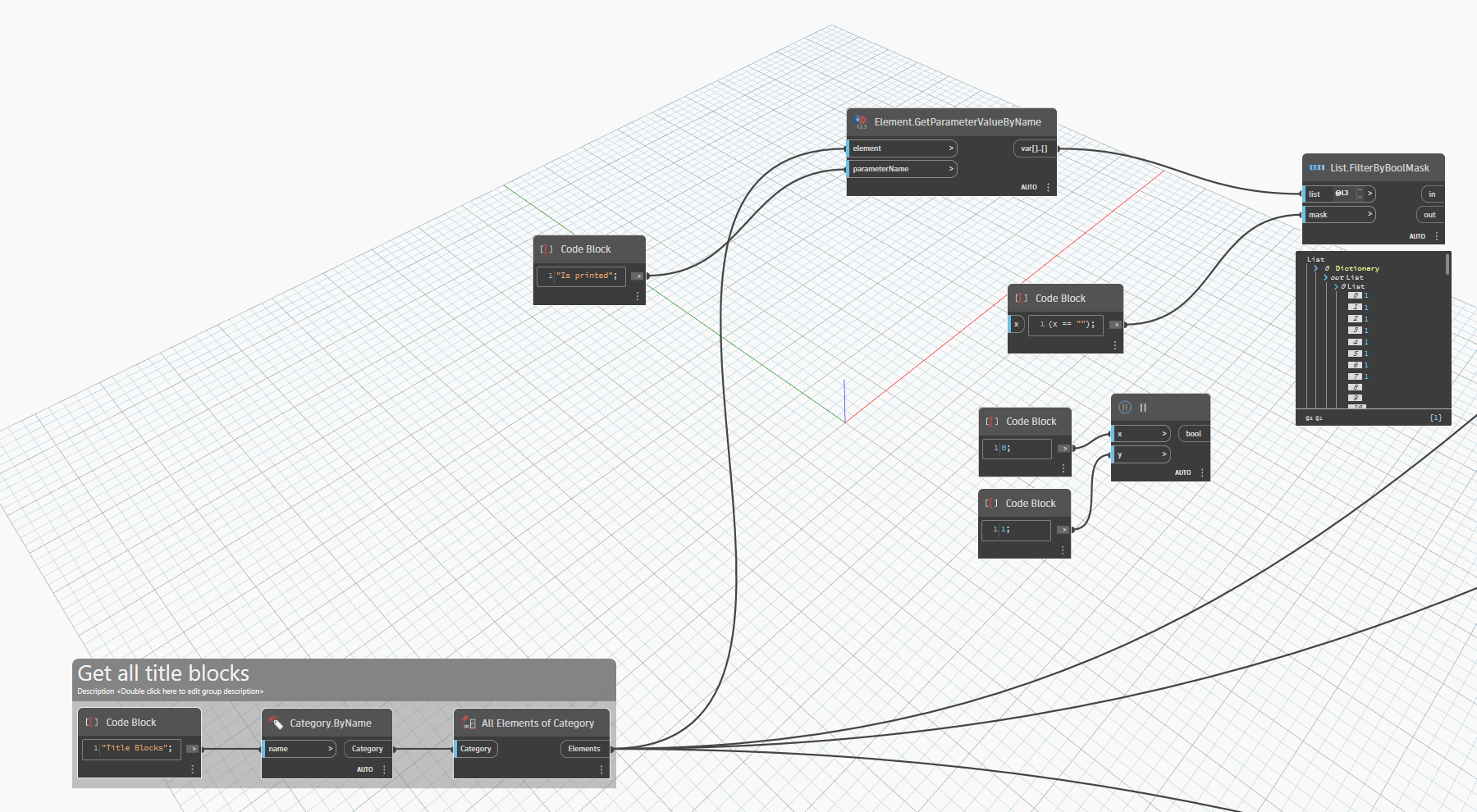

There is a few of the title blocks which do not contain this parameter, therefor the index is empty.
Is it not better to just filter those out first?
Also shouldn’t this do the trick for the empty values?
Also this should work (an alternative).
If needed true can be 1 and false can be 0.
