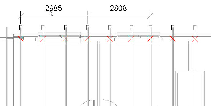

I am trying to setup a workflow where i based on intersections between walls and rafters, automatically place roof anchors based on the points collected.
But when getting to the point of creating the part which on the basis of an maximum distance input, ensures that families aren’t placed at every rafter, but with a maximum distance between the elements - i really start to struggle.
I have identified the start point, and the distance from this point, to the remaining points - i however cant really grasp the logic of how to filter the points from here.
