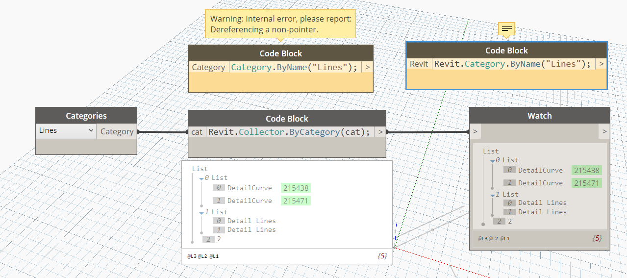

@NaSha You could try using a design script solution and see if that freezes?
This uses the logic @mellouze stated in the post above. :+1:

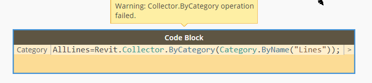

@Ewan_Opie Nice! I wonder why it’s not working for me :roll_eyes:
Can you break it out and see which side of the road the error occurs on?
Could be a conflicting package. Try specifying Revit?
@Ewan_Opie :roll_eyes:

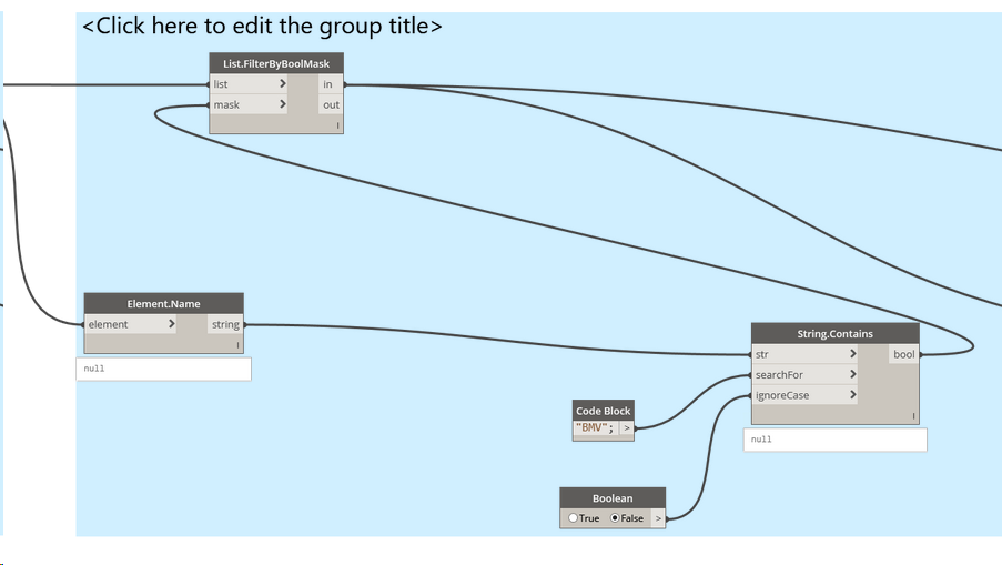

Try by node: List.FilterByBoolMask.
Below part of my script, which filter elements by word “BMV”
obraz
I hope it will be helpful.
Hey you don’t need the boolean value set to false on the string.contains :slight_smile:
It is set to false as default.
