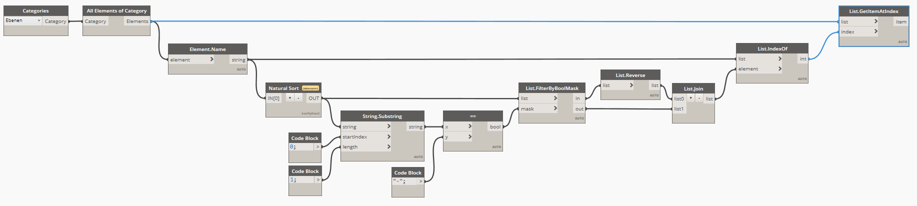

Hi @Glutinator030 ,
Is there a specific reason why you need to use Python instead of Dynamo Nodes? The filtering you are describing can be easily done with OOTB Dynamo Nodes.
Do you have any suggestions? :slight_smile:
Something like this should get you started :smiley:
