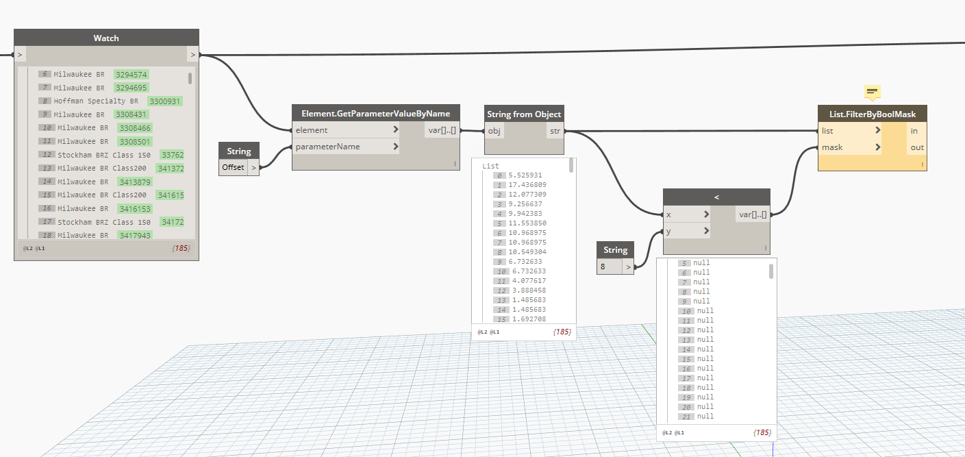

I’m looking to filter my pipe accessories elements based on whether or not they are above or below the wall height (8 ft). Then I need to apply a comment to them depending on which they fall under. I’ve managed to get their offsets, but now how do I filter those offsets into two categories: less than or greater than?

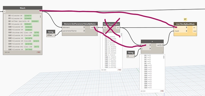

Use a Less Than or Greater Than node and List.FilterByBoolMask to filter the elements (not the values) by whether or not they meet the Less/Greater Than condition.
What do you mean by filter the elements and not the values? This is what I have, but it’s not working.
You need numbers (doubles) not strings
