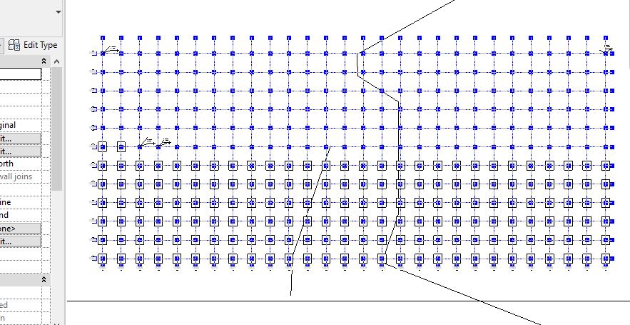

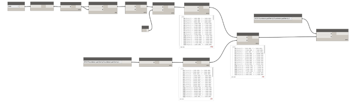

i experimenting with a script, and the long and short of it is, i want to know if i can filter list coordinates (points), when all i have is a list of the points i do not want. i.e. can i remove a whole bunch of items from a list in an automated by imputing the ones i want to eliminate? I am working on script where, imagine you want decrease the length of grid spans, which would increase the number of pad foundations. i want to filter out the points that already have foundations and create new ones only on the ones don’t.

P.S. Sorry for the typing errors. i just thought i would add, the points in list 2 are from the pad foundations and the list 1 is from the grid intersects. The only thing i have is that a number of the values will be identical and i’m hoping this can give me something to work with.
Hi @sammgking,

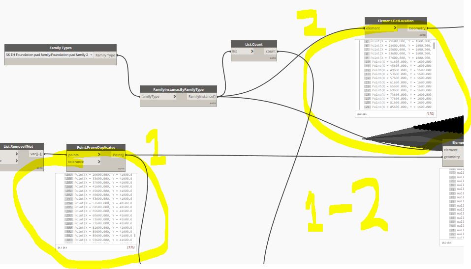

These nodes might be able to help you get the results you need.
All Grid Intersections
Foundations with Footing
Foundations without Footing (aka the difference)

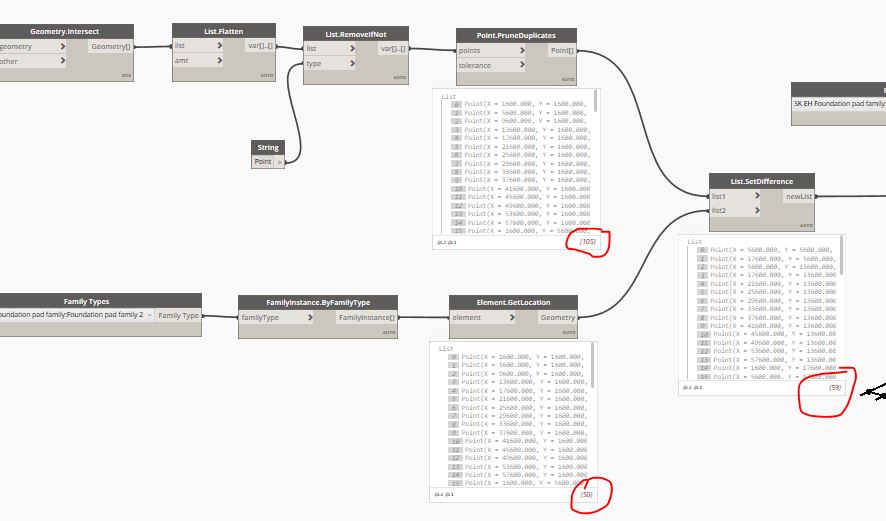

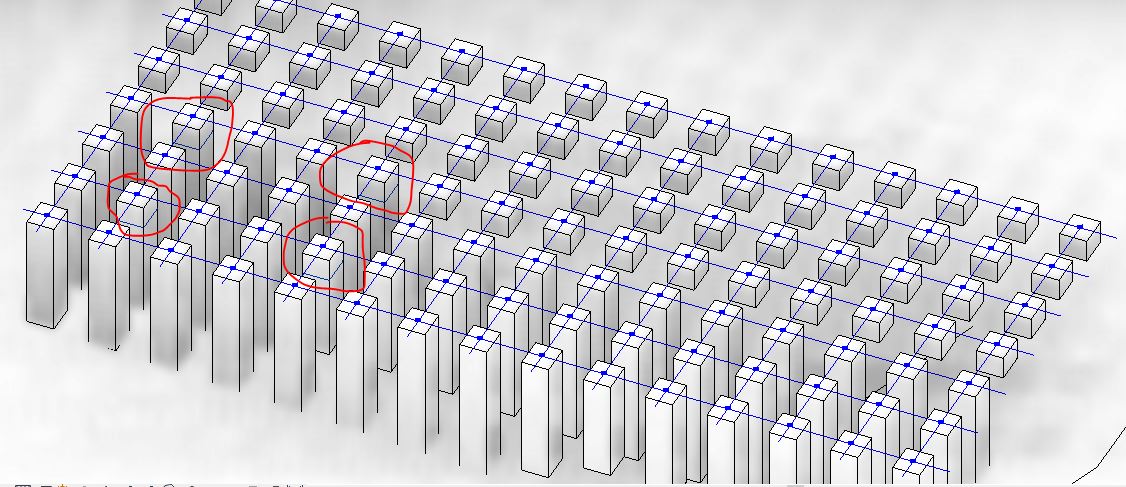

This is exactly what i want. The thing is it seems to be leaving a few points in the list. I’ve tried a few things but i’m basically stumped as to why its doing that. Its funny because I think when i do it exactly as in your image it works fine (i.e. just making the area larger instead of changing the spans and moving foundations). Still, it seems funny, cant see why its not taking everything out. Any ideas?

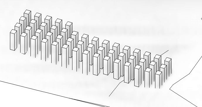

If you take a closer look at those 4 circled foundation, there are two foundations at each location (one small cuboid and and one tall cuboid). So you would be getting 8 points instead of 4. And since Dynamo is only subtracting the 4 points which match the grid points. So instead of being left with 55 points you are left with 59 points (55+(8-4)).
umm? not sure i follow. The smaller foundations are ones that were created by the script where it shouldn’t have. In theory it should have taken 50 values from 105 leaving 55. But for some reason it leaves four in. This is how it was before running the script. Strange??

I tried everything that I could but it seems like Dynamo has some trouble understanding that those are same points!
To my surprise, it works when I convert the point to a string.
Probably a bug or we are missing out on something crucial.
