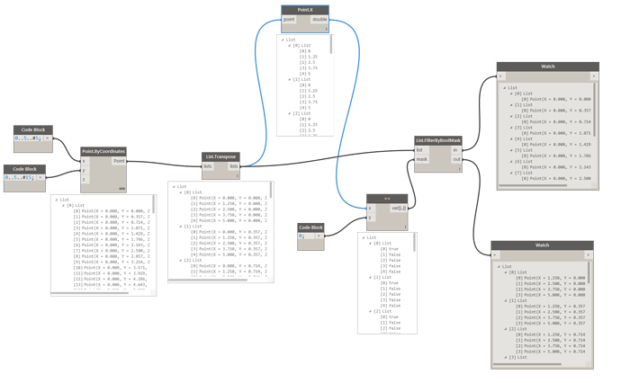

would it be possible to remove some points in a list by some criteria? For example, the points at origin?
I am using revit 2014 and dynamo 0.8.2 for this task, thank you in advance.
Hi Norris. One way to do that and very simple is like this
Ask for the coordenate X of the points and then use a list filter by bool mask :wink:
