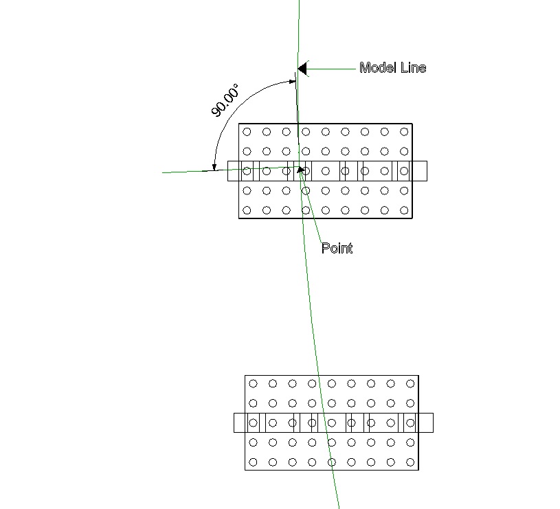

i want instal family at point and rotate perpendicularly to the line around the model line at the point.
but i’m stuck at the rotate node
Can you help me?

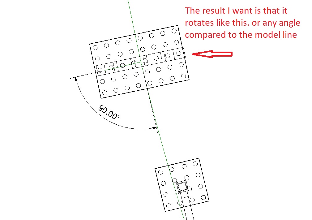

Hi Kulkul
I tried it and the results were not what I expected.
Can you help me solve it?

You where missing some inputs. Try this script instance and rotation family(Kulkul).dyn (74.3 KB)
