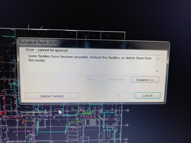

Iam trying to update revit model from 2015 version to 2020 version through rhythm package , the code is running without any problem , but message appears as in picture , and all fittings are deleted from revit model , how to solve this problem
They are probably corrupt at some point in the process. Try upgrading one build at a time (2016 > 2017 > 2018 > etc…). Generally otherwise you will just lose some of these objects in my experience.
