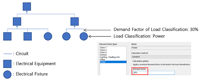

I would like to copy the Demand Factor from the Load Classification assigned to each Electrical Fixture into the connected Circuit. This should apply to all connections, not just one.
Any help would be greatly appreciated.
typically, it involves accessing the factor value first, and querying the used connectors then fetch their owners and assign the value onto them. in some cases, cuz there are multiple connected elements, eventually u would get multiple values queuing for assignment then it’s up to u to determine their priorities.
