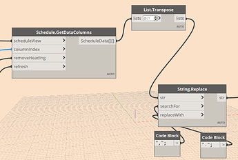

What this dynamo does:
- Export columns with data of certain schedules to columns in excel on multiple sheets
- Changes the format of the data (area) from 9,999.99 to 9.999,99 so that excel recognizes the data as numbers (so you can use formulas on them)
- Creates a new file (read: copy) from a template file and lets the user choose (pop-up) how the new file should be named and to which folder you want to save it
- Generates a date-stamp in (European format) to the first excel-sheet

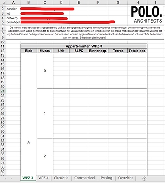

- Let dynamo format the table in excel. Right now everything is set in the template because I know the amount of units per floor and per building, but for other projects the amount of units could be different so the lines have to be put in other places… This is what the excel-template looks like right now:
