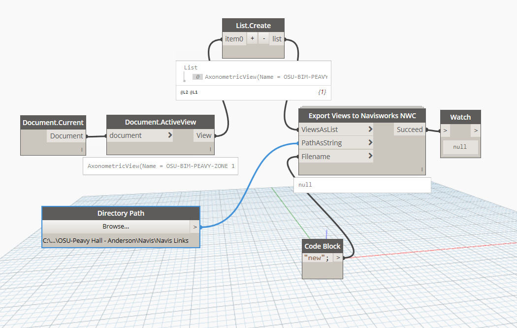

I’m trying to create 2 procedures:
  1. Exports current 3d view as NWC (Navisworks); saves to given project folder. View name = filename
  2. Exports ALL 3d views with specific keyword and saves to project folder, View name = filename, same as above.
my current “code” for #1 doesn’t really want to work for some reason…
this is getting funny. The code for procedure #1 is below… now the problem is I can only execute it once!!!
since nothing is changing on Dynamo side it thinks I don’t need to re-create the file… very annoying!
can someone smarter than me explain how to fight this behavior?

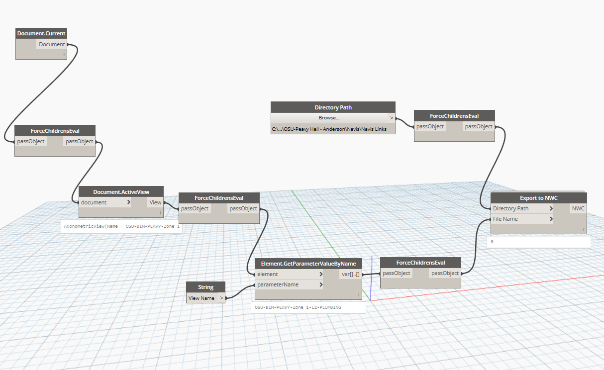

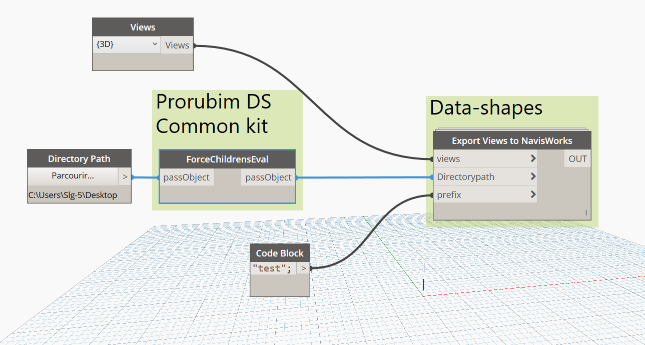

try this :
The ForceChildrensEval node will force the script to rerun every time you press execute in manual mode.
(the data-shapes navisworks export node is not necessary… it’s just the only one I have installed :slight_smile: )
yeah… this is an interesting idea! Still doesn’t re-run when i just flip between views…tried to place this force_eval everywhere I can but no luck…
