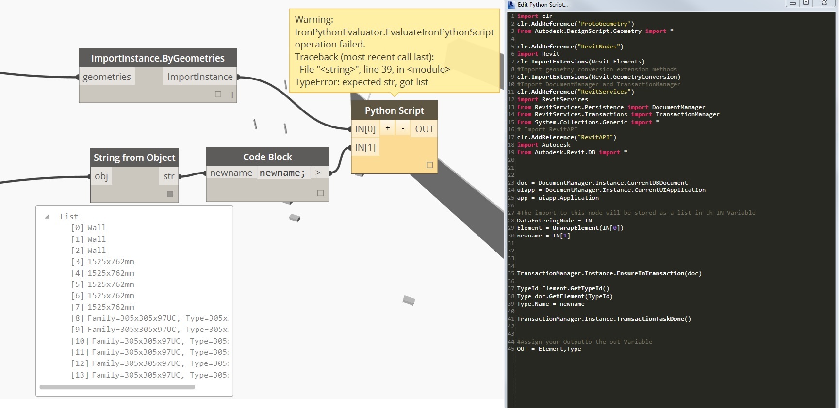

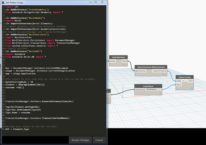

Yes you can do this, but it has to be done after the import is done. So you would get the solids, import into Revit as SAT geometry, then rename all of the imported SAT Geometries with whatever name you choose. See attached image.
Im getting an error any ideas, thank you for your help with this !!!

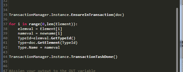

Sorry- my script is written to only do one element. You need to edit the Python to work with lists. See below:
thanks for that i seem to have another error now …
File “<string>”, line 37, in <module>
TypeError: len() of unsized object
… wish i new python this would!
my last post was my fault!!! all is working
