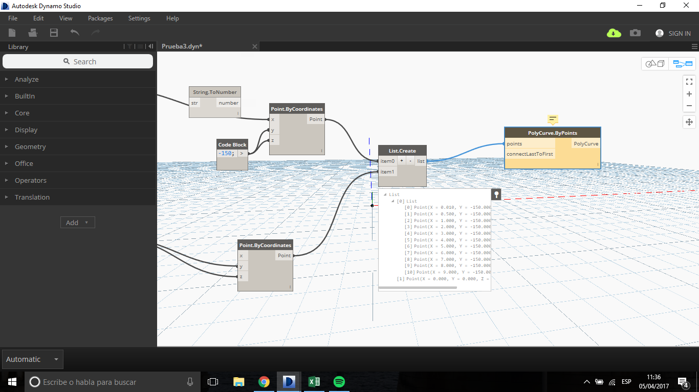

Really, I want to split up each value of [0] List (values import from Excel) (see photo)
Once, I have each independent value I want, in a iterative way, for example, at first value [0] Point (X=0.01 Y=-150 Z=-150) with value that appears in [1] List which value is Point (X=0 Y=0 Z=0), and they create a line or a curve with both coordinates; Secondly, [1] Point (X=0.5 Y=-150 Z=-150) with [1] List which value is Point (X=0 Y=0 Z=0) and it genarates a new line or curve, and it eliminates the last line or curve.
My goal is to get a polycurve or line that generates a displacement.

Still not sure if this is what you mean.
Firstly, thanks a lot for the help!!
I want exactly that idea, due to I’m searching a displacement of a line, but I want an automatic movement without click on the “integer slider”…I don’t know if it could be possible, I have read abaout to create a loop with for in “code block”…I’m new using Dynamo.
